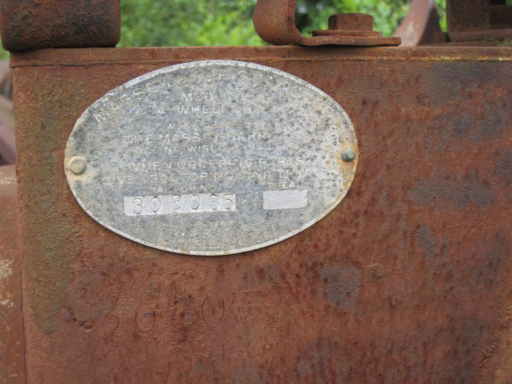

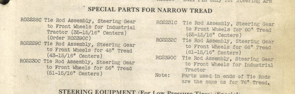

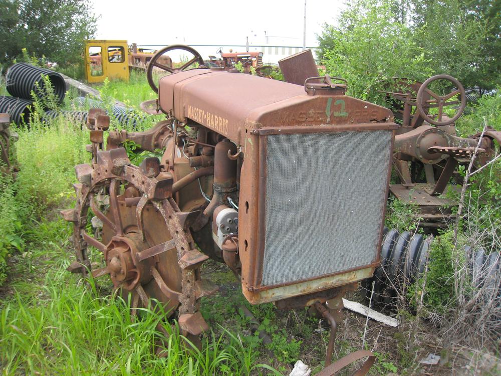

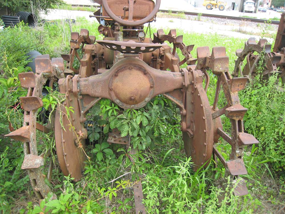

Yes they were offered in the Industrial version with the OHV GP. Here is a picture of Parts list number 32-A  with just some of the parts listed for the OHV Industrial Notice the 35-15/16" Centers verses the 43-15/16" Centers.... Also here is a picture of an OHV Industrial  Serail # 303035 notice the width is not stamped but it is an Industrial.

What exact measurement do you think they are referring to when they say "centres"?

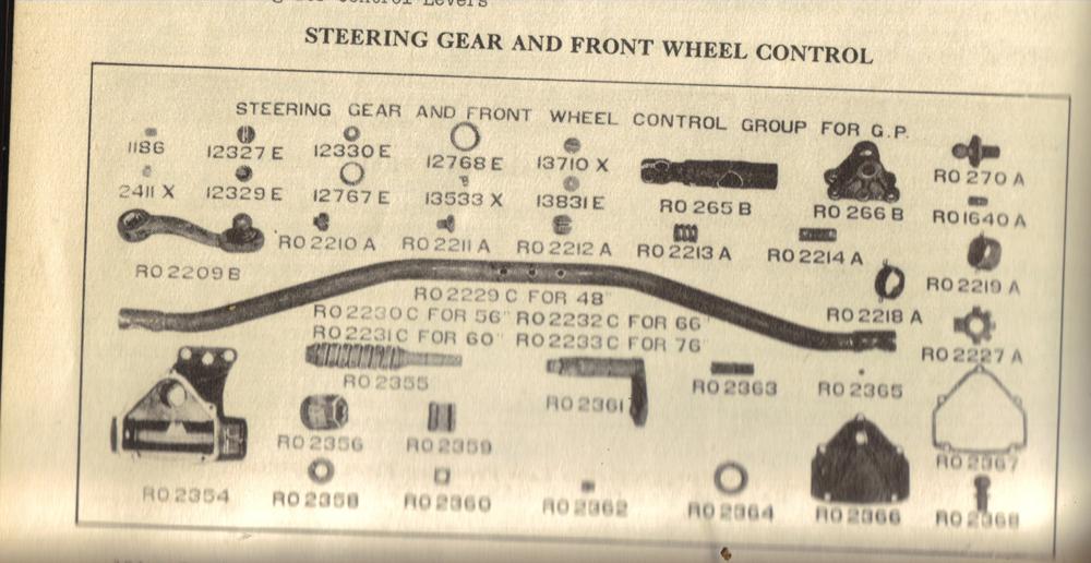

I believe what they mean by Centers is the meaurement from the center of the left Ball Joint to the Center of the right Ball joint. It appears that the part # RO2228C is refering to the Steering drag link " Large Tie Rod  pipe between wheels holding Steering Ball joints". here is a picture from the book.

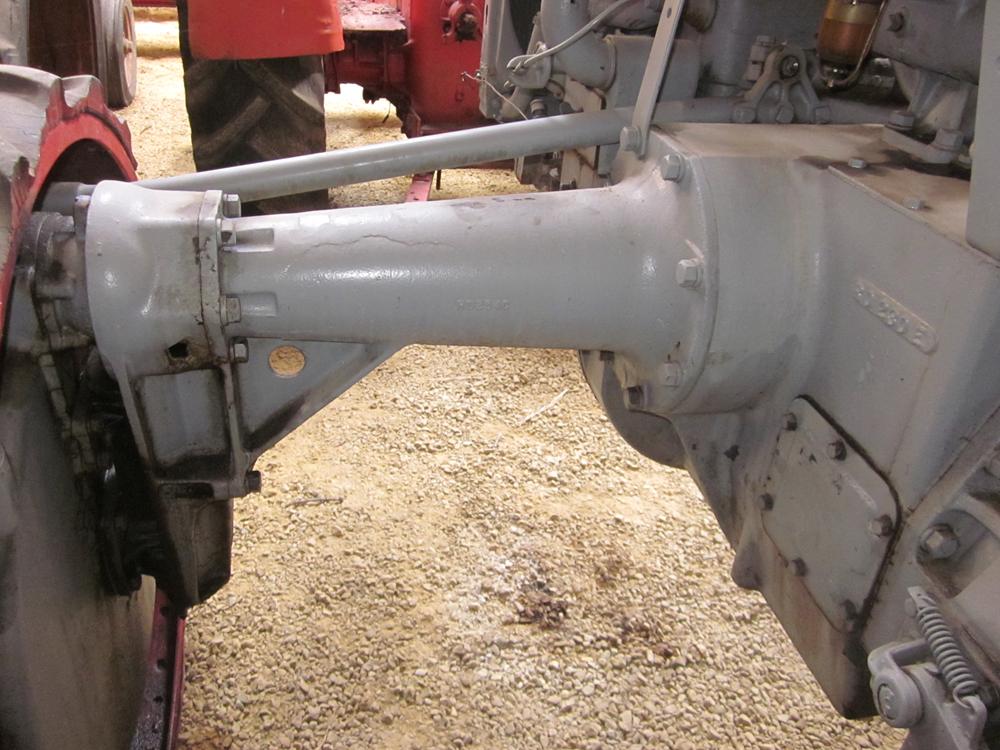

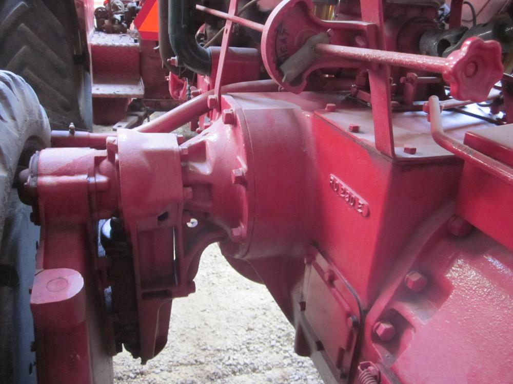

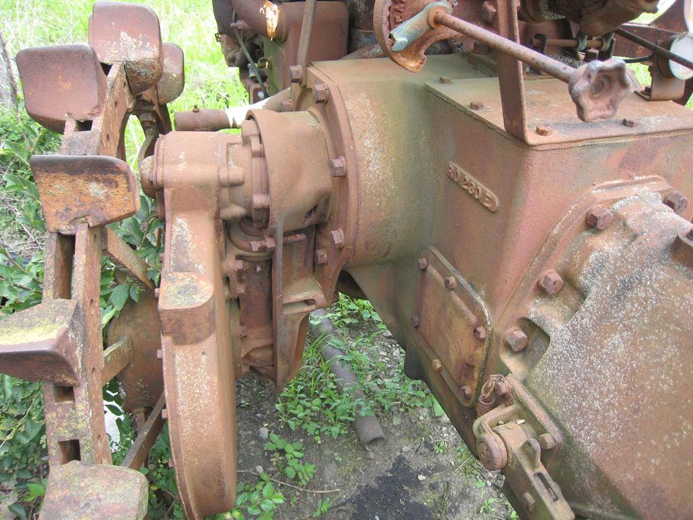

When I took these picture sometime back I really did not know what to look for so did not get a pictue from the front of the drop housing but did get one from the back. By looking at the pictue from the back it does not appear to have the extra piece cast into it like yours but I am just wondering if yours is a special piece made just for a front plow???  I do know this is an Industrial as you can't get it any narrower than this as the drop housing piece is only about 3/4 inch away from the transmition case.
I went back on here and added the picture of my housing so you can see them side by side to see the difference.

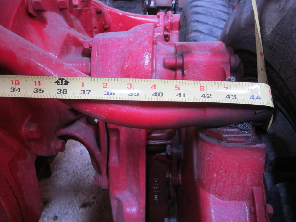

Just went out and measured my 48 inch GP. It is hard to get a good measurement trying to get the tape strung through the back of the engine and hooked near the center of the other ball joint and run a camera at the same time but here it is. Yours should be at 35 & 15/16 as my tractor is just what it said 43 & 15/16.
The second picture shows just how much wider my housing is than the Industrial and the 3rd picture shows just how much wider the housing is on a 76 inch tractor wich is the widest of them all.

Thanks for that Joe - it all makes sense.

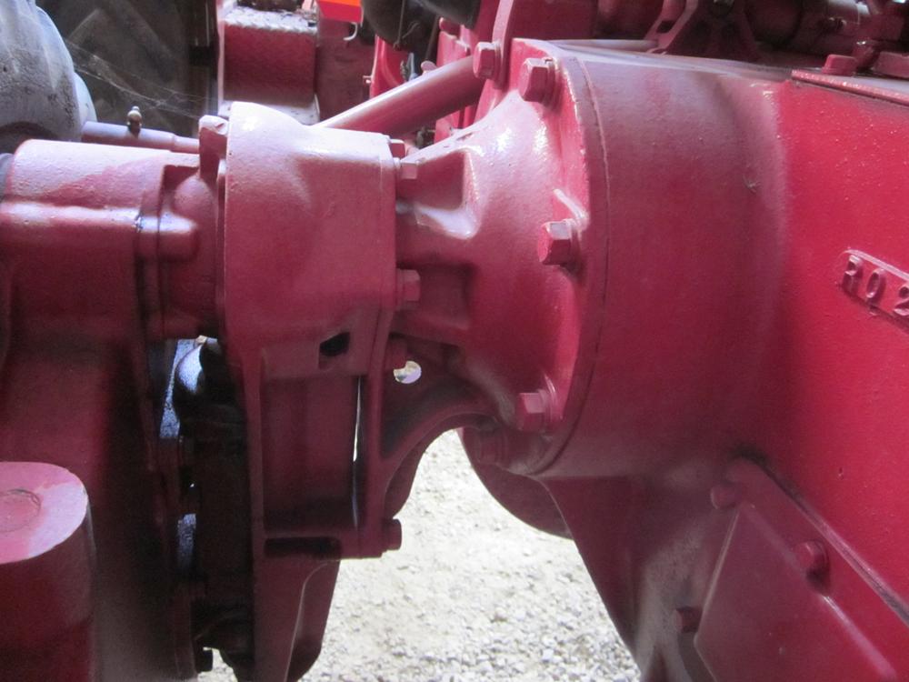

As for the "attachment points for a plough or bracket" - call them what you will - on mine these are part of the main wheel gear housing casting and not bolt ons.  It begs the question what exactly is this tractor you have found?  It undoubtedly has the very narrow axle arrangement of an industrial but what has happened to its "industrial" cast wheels?  I can't get in the sheds at the moment to take a photo because of massive frozen snow drifts against the doors.

Will photograph that industrial bracket arrangment as soon as I can get in the shed.
Something nagging me that the tractor you have shown is something of a hybrid - definitely an industrial axle set up but wheels odd, where's the industrial wheels and the bracket arrangment.  Maybe a spare industrial chassis sold off as an agricultural?  Have you checked the front track width - is it industrial width too?
