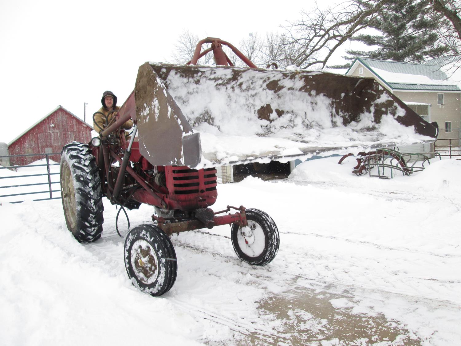

Here is a photo of it for your enjoyment
