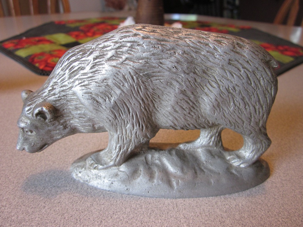

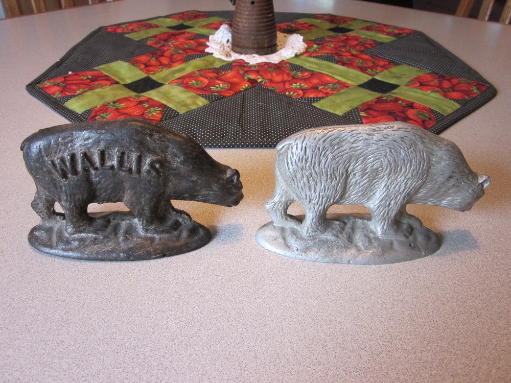

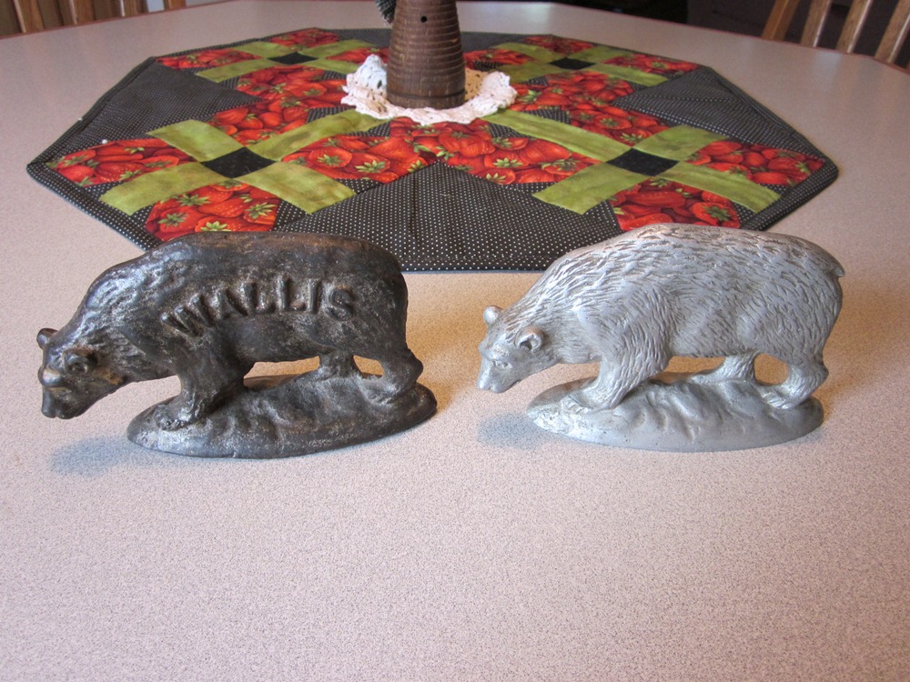

Now I got a early Wallis question for you, what do you think of these Bears? I got this Aluminum Bear on ebay about a year ago the man I got it from said it came from a garage sale about six blocks from the Wallis factory.
I truely believe it was an early prototype bear before the the Wallis name was added to the mold. It is so finely detailed with all the bear hair and creveses also it has very good patina wich would be consistant of a piece this old.
Here it is next to a cast bear, what do you think?

Haven't a clue about your Wallis bear but it's origins do suggest that it is genuine - and the patina adds to the theory as you say.

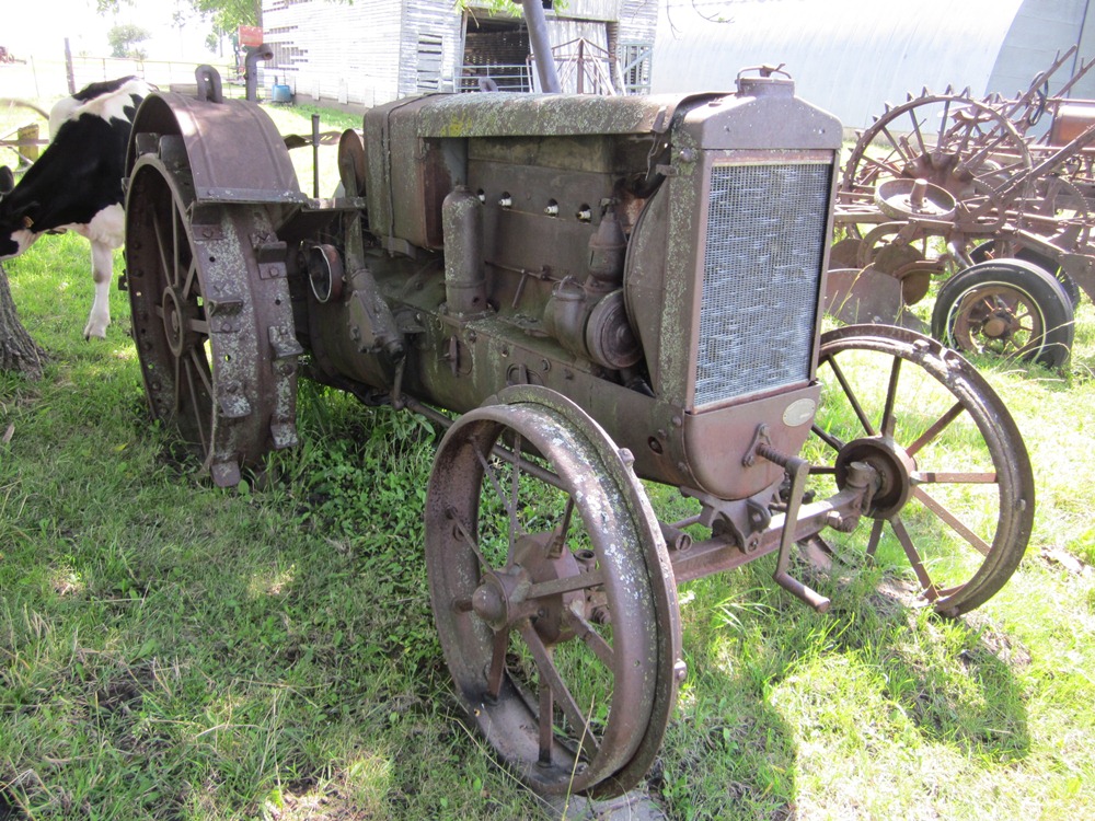

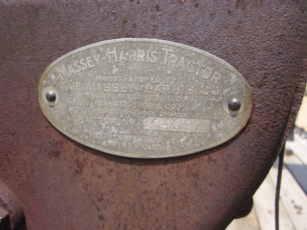

I know this is not a Wallis but this is my Kill for today, it is freshly out of the cow yard. I got it home and in no time got it unstuck and all valves loose. This is a Massey Harris 12-20 as the tag shows, there should be alot of these arround but you don't see as many of these as the Wallis 12-20.

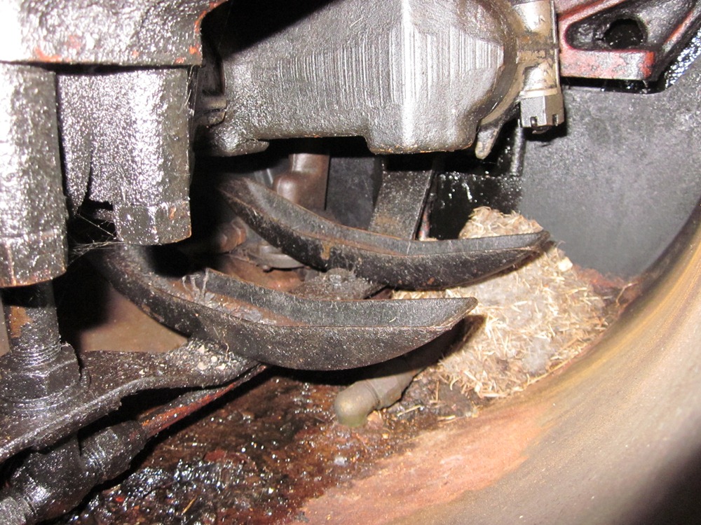

From the third picture I believe I have rescued this tractor in just the nick of time as you can see the friendly mouse has just taken up residency not long ago. I will have to evict him soon so he will not ruin another tractor for me. From the looks of the pile the little fella must have came in through the clutch area?? Must be the way in??

I like your proto type Bear, great detail and nice to have on the shelf with the others.

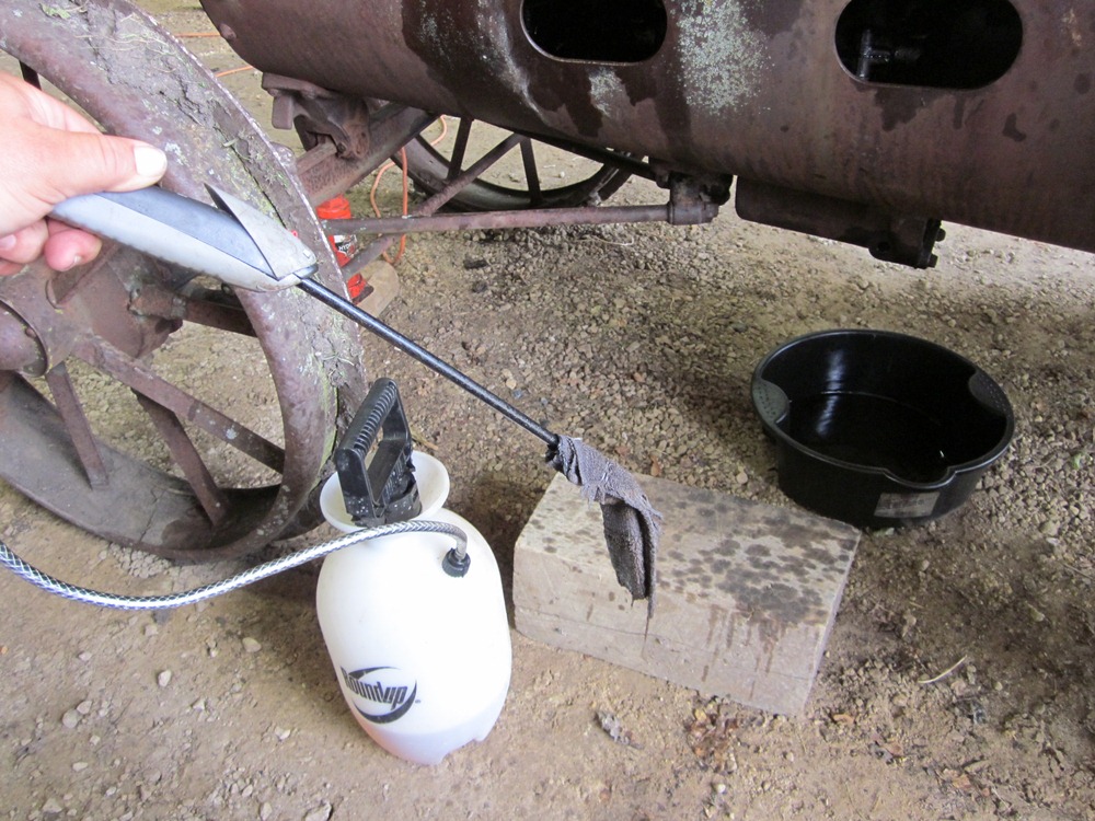

Working on the little 12-20 today and I came up with a very easy way to clean out the oil pan, you got to try this as you know how hard it is to get your hands in there to work.
First take out the oil pans this is done very easily with the two bolts holding them in this will make for alot more room and give you a chance to look for leaks in the pans and repair if needed.
Then take a weed sprayer with a plastic nozel and wrap a small rag arround the end and wire it to it. Fill sprayer with gas and pump it up and start spraying inside the oil pan wile swishing it back and fourth like a little mop. This really works great as it will swish in the smallest of places, pull the trigger and add more gas as needed.
I cleaned the entire engine out with about two quarts of gas this is about 1/4th what my old method used with a paint brush. You can buy a cheap weed sprayer here for about $8-10.00  this is the same weed sprayer I use to soak my tractors with the 50/50 mix of oil and diesel so I already had the sprayer.
You gota try this it really works great!!

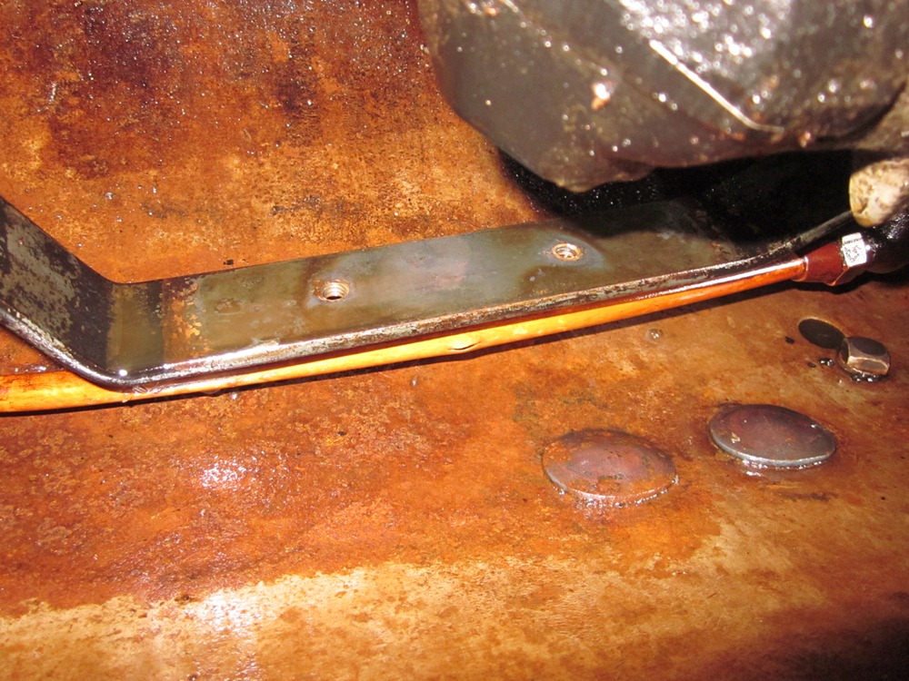

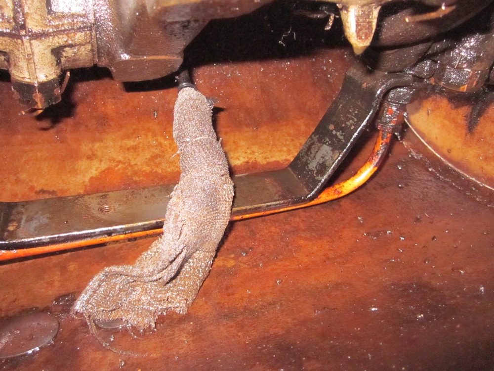

When cleaning the oil pan on a U frame tractor you must always check the oil lines for Ice Bursts like the one in the picure below. If not fixed your engine will not get oiled properly and will soon be in need of repair.

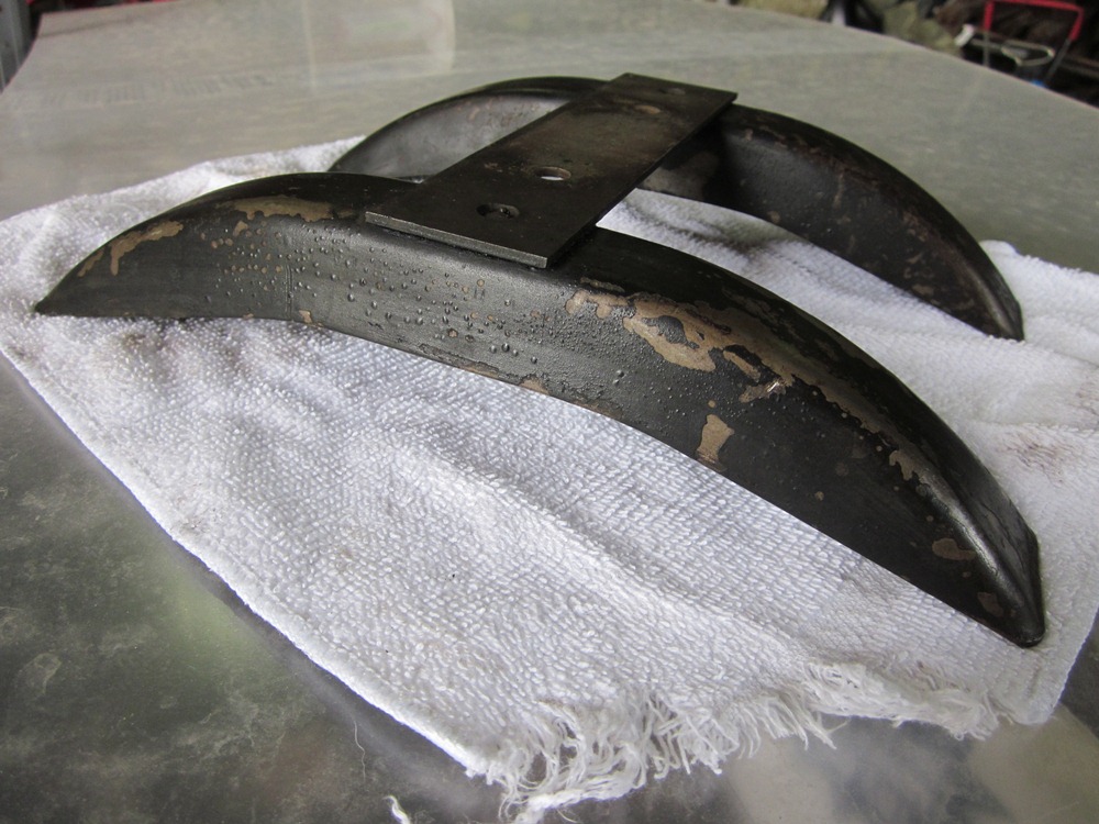

When I took the oil pans out of this little 12-20 and cleaned them up I noticed something I have not come across before. These seem to be painted the dark black color the same color as my little original 12-20 is. Do you supose this engine was painted before it was set into the frame?? Or possibly these trays could have been replaced at one time or another?? I can't really see a reason for painting them this color but if it were painted before the engine was dropped into the frame this would make sense.

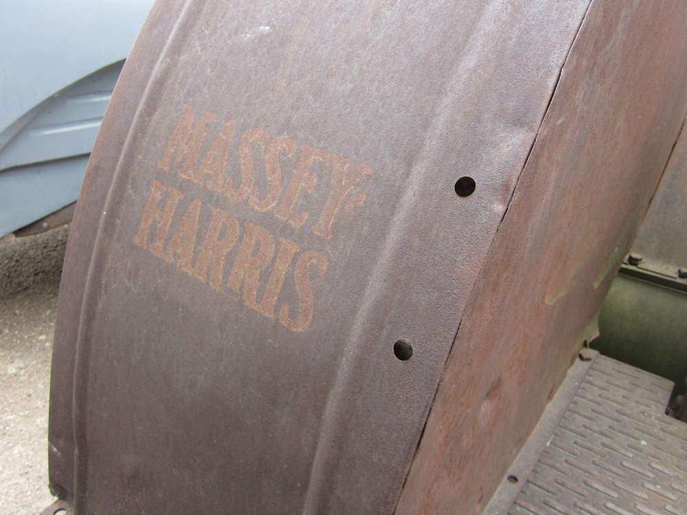

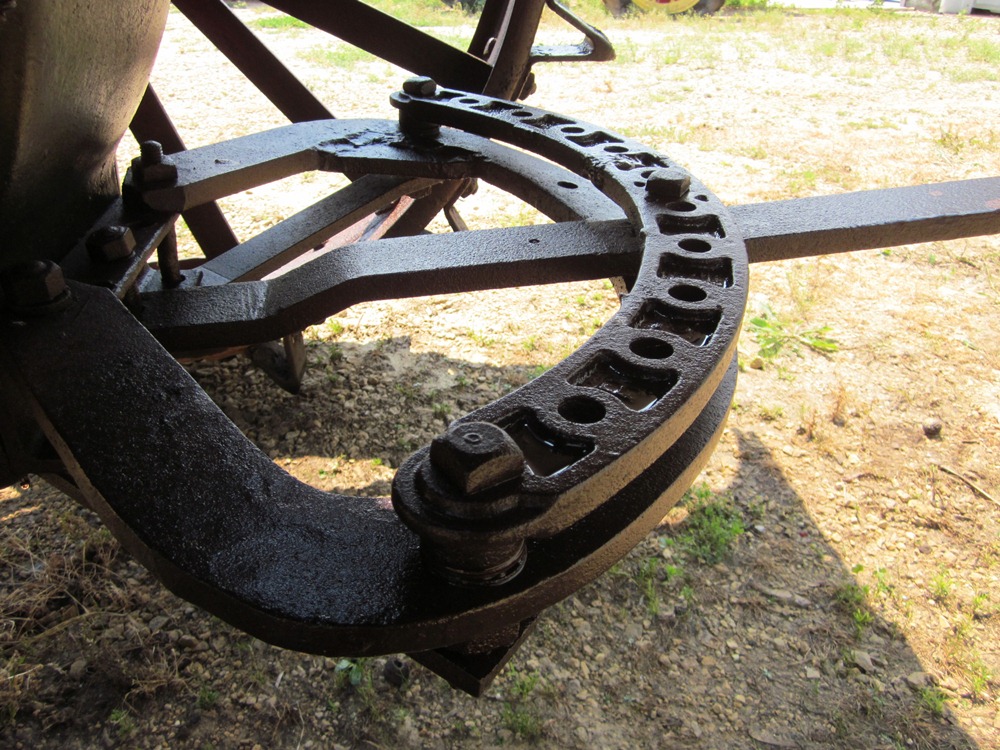

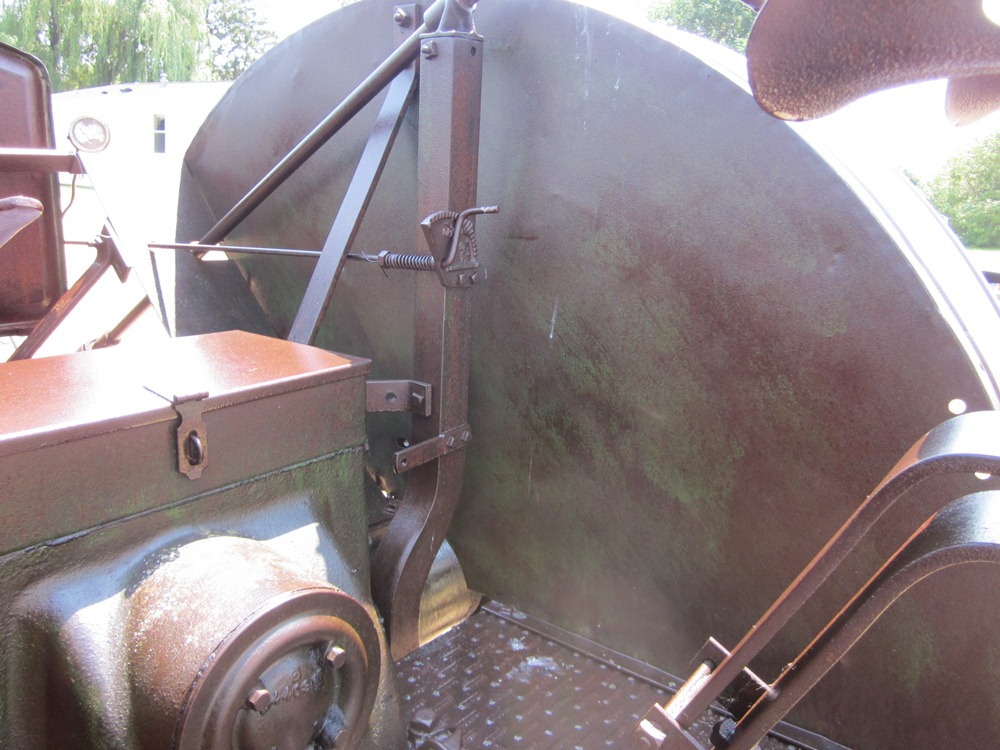

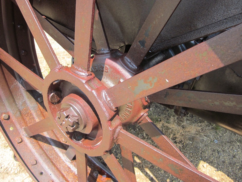

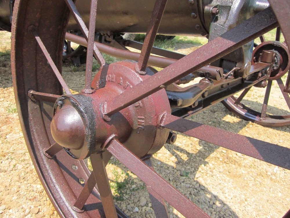

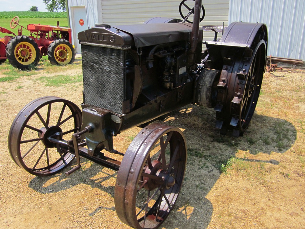

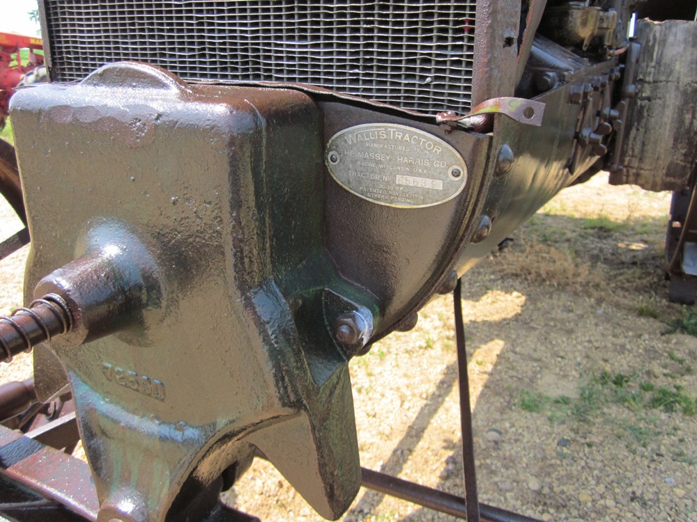

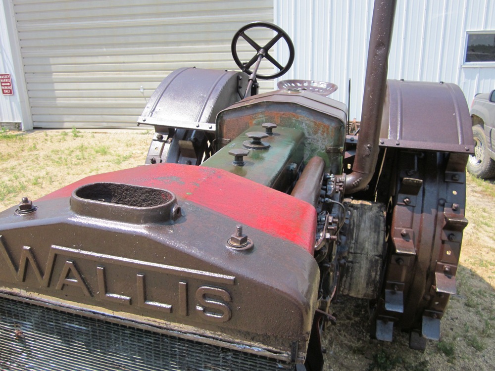

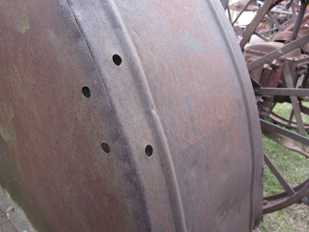

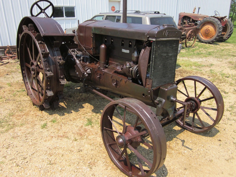

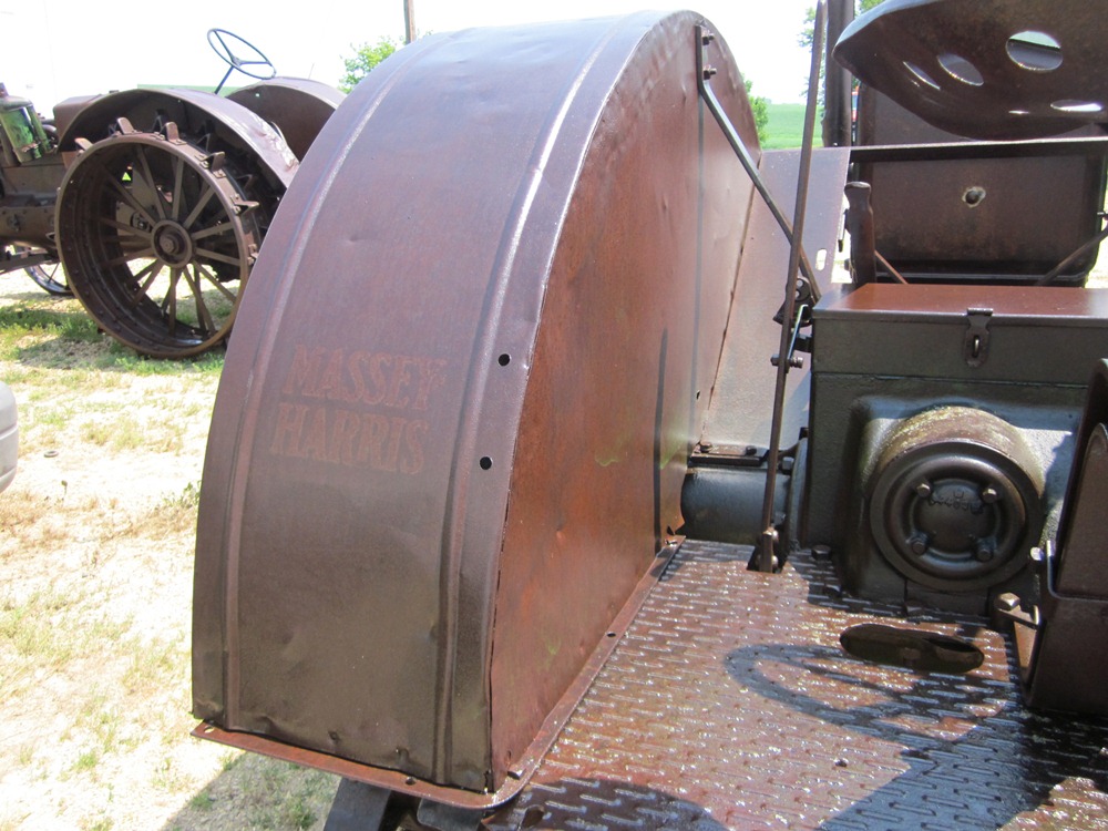

Well as I said on another thread I would post pictures of a 20-30 I picked up yesterday. Here it is all oiled up like a pretty girl in a swimsuit contest. This tractor is a very nice original with alot of green paint on it yet, for some reason someone painted part of the radiator top and some of the engine red years ago. This tractor is equiped with a swinging drawbar that is in very good shape. It will need a litle work on the radiator and water pump but it should run with not much work at all compared to most this age. There are some holes in the fenders that I can't explain and have not seen before, any ideas on this? They apear to be factory holes possily for a light bracket?? Has anyone out there come across this on another Wallis? Also the "Massey Harris" decal is higher up on the rear fenders and there is no "Wallis" decal running up and down the fender, could this be sometime in the changeover or did they just run out of Wallis decals that day?
